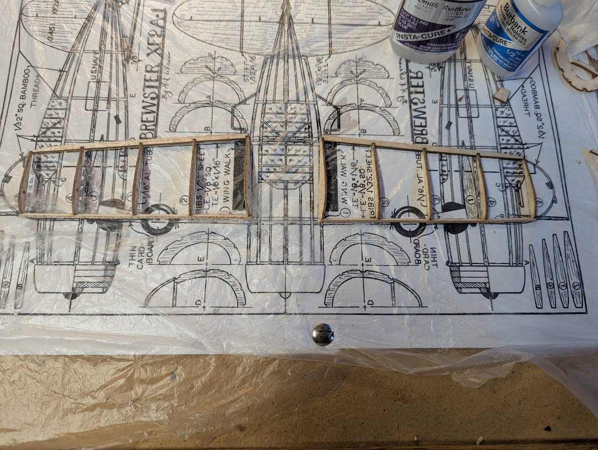

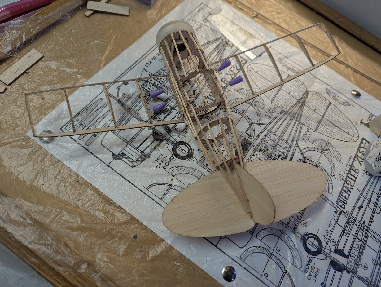

I got back to work on the wings. I did do a slight redesign but it is still going to have bamboo wing tips as the plan called for. This is not my first experience with 1930s building techniques.

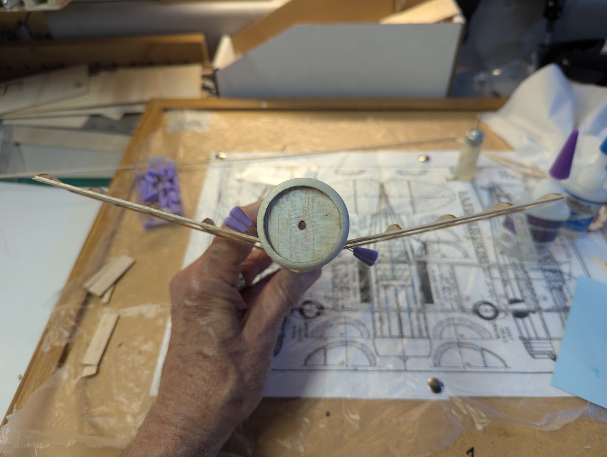

As you can see this model needs substantial dihedral.
The obligatory "bones" shot. The tail feathers are 1/32" sheet as on the original plans.

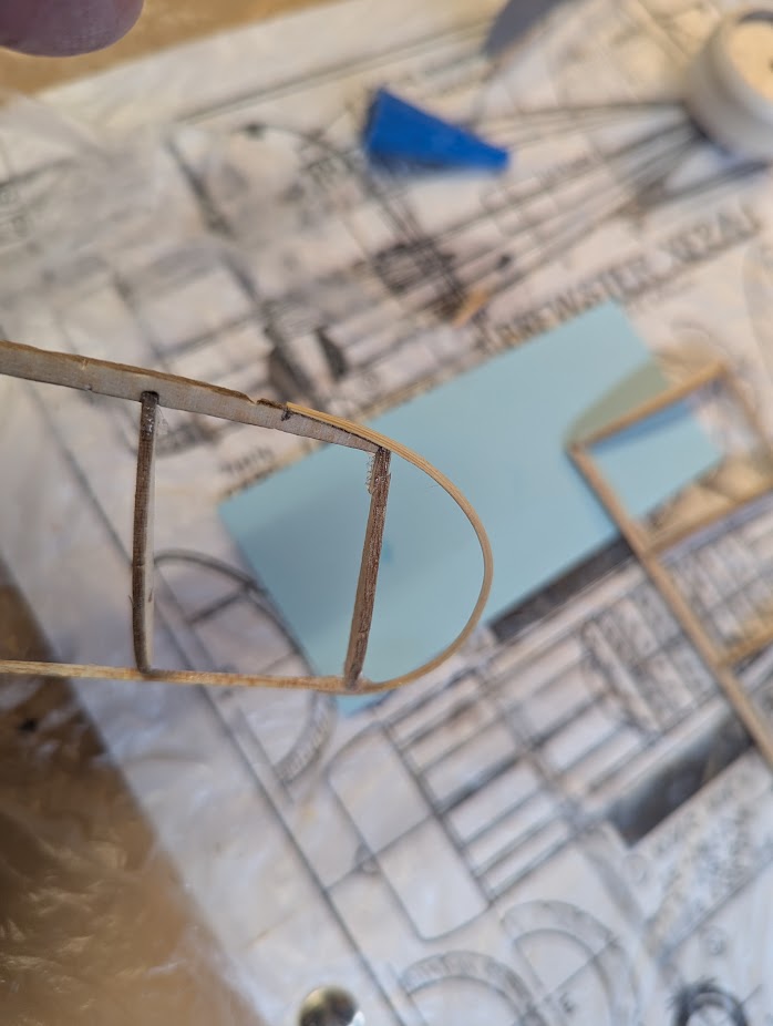

I used to bend bamboo around an incandescent light bulb but it's all LED around here now so not enough heat. I didn't want to have an open flame on the work bench but I hit on the idea of setting my heat gun on it's back on the bench and bending the bamboo around the nozzle. The picture is just for illustration, you have to use both hands while bending.

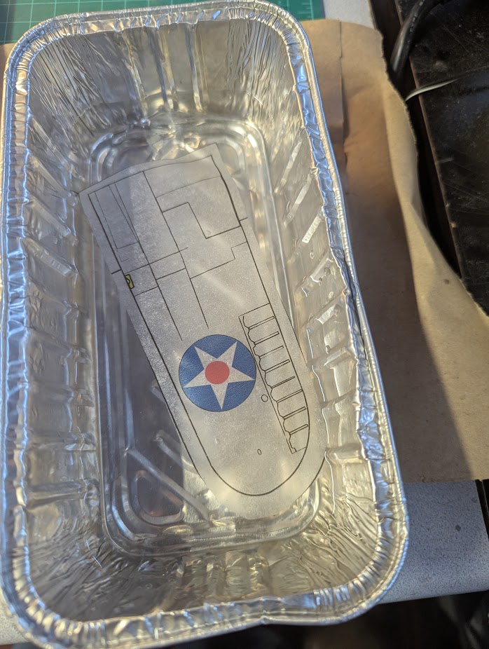

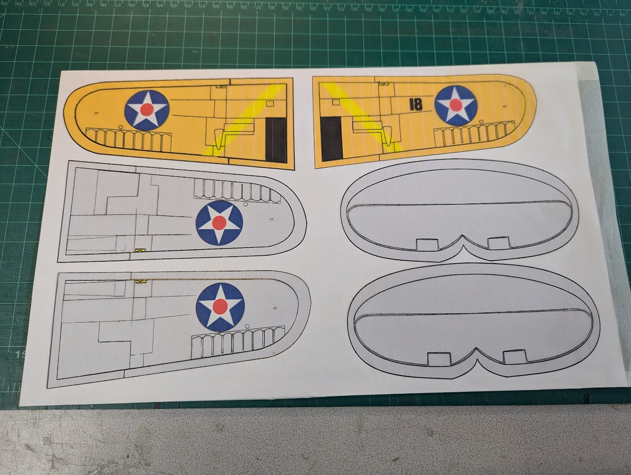

These are the skins I printed for the wing and stabilizer. This was relatively simple.
The fuselage, not so much. I had to print several bond paper test images to test the fit.
This is the smallest model that I have wet covered.
