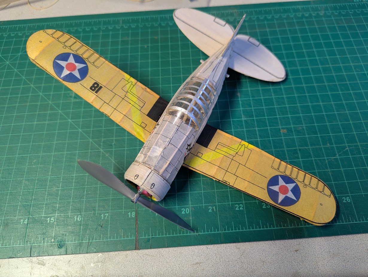

These are the skins I printed for the wing and stabilizer. This was relatively simple.
The fuselage, not so much. I had to print several bond paper test images to test the fit.
This is the smallest model that I have wet covered.
The wings weren't a problem although since I based the skins on my NoCal F2A skins they come out looking cartoonish on a dimensional model. So, I set up to do the fuselage

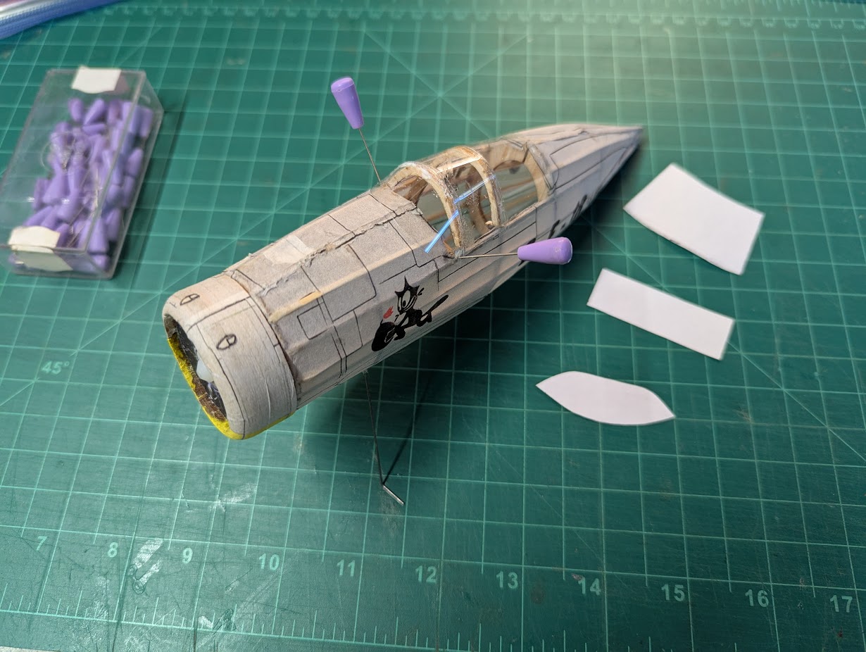

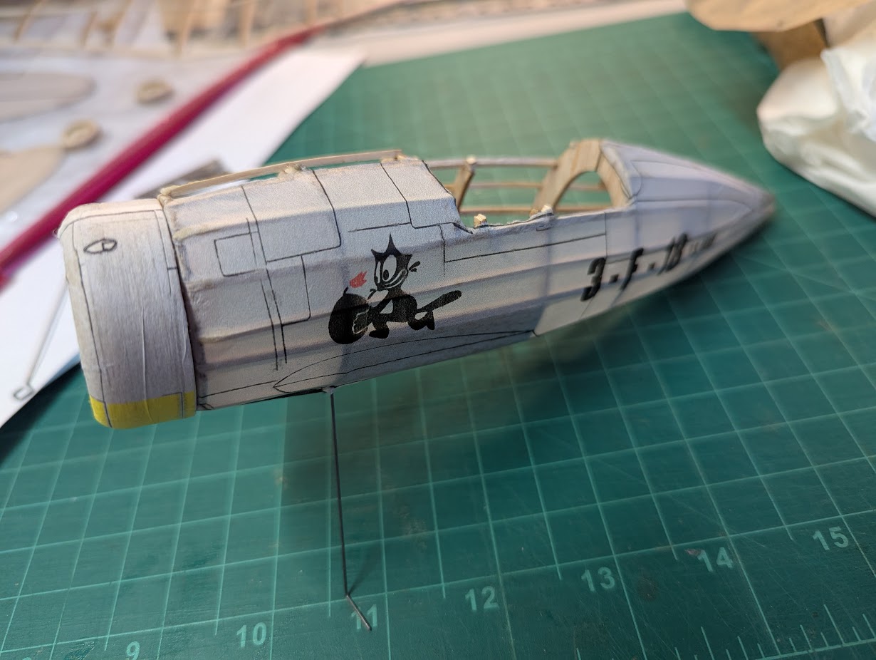

Re: A Different Peanut

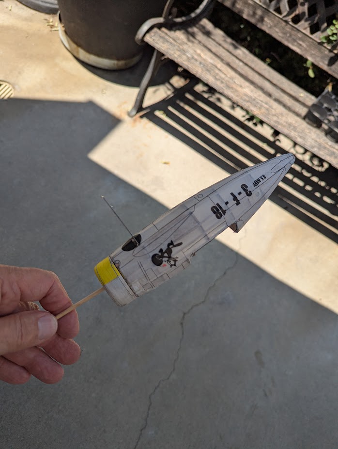

The first side went on easily enough.
The second side was more work. I took it outside to mist it with Krylon.
Like most 1930s plans the patterns for the canopy were something you had to work out for yourself.

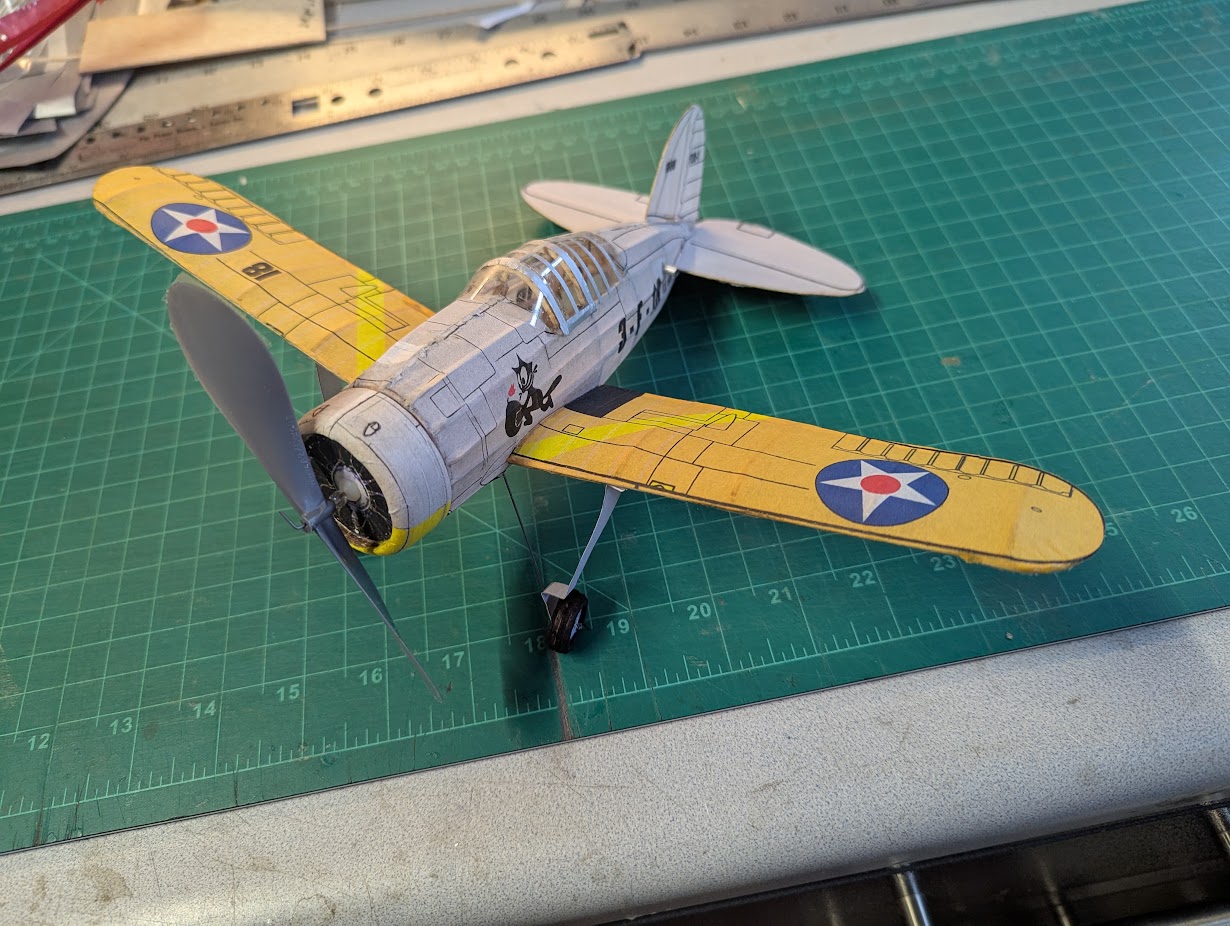

This is what it looks like finished. Now to see if it will fly.
I took it to the OFFC meeting at the end of the month.I only had a few minutes to trim it because there was a P-18 contest that morning and the time I had was from the end of the contest until we had to give up the gym. Fortunately, it flew stabily from the start. Since it is rather draggy ( I think that I should have built it gear up.) it does need more power, so I will have to use 3/32" rubber instead of the 1/16" I had in it. I got flights all the way the length of the gym but it doesn't want to turn. I decided to try try trimming it outdoors at the Black Sheep LoCal contest on Sunday morning.
I took it to the LoCal contest (Finished second with my 15 year old P-51.) to see how it did outdoors. I put some larger, 3/32", rubber in it. It was a bit tail heavy with that rubber but I didn't have any stall/spin crashes and it's still in one piece. A little clay in the cowl fixed the tail heavy problem. With enough winds in it to get a long flight it has trouble handling the torque on launch but if the rubber is backed off it won't climb. I' thought to try a smaller prop. There was a slight breeze and it had some trouble with penetration because it is rather draggy. I think I should have built it "gear up" even though our indoor Peanut contests have an ROG bonus.

I clipped the gear off ot it. Only saved 0.84 grams but the reduction in drag was stunning. However it does look cuter sitting on the gear.
I took it to the OFFC meeting least Wednesday and started some low powered trimming flights. When it was trimmed to turn comfortably in the middle of the room it would fly for a while then spin in https://www.youtube.com/watch?v=LXA9I3feqLo but, if I opened the turn, it took the whole width of the room to circle. https://www.youtube.com/watch?v=EGkCL5noPAk I was afraid to put enough turns into it to get it to climb in the gym so I packed it up and flew another model. On the way home it occurred to me that maybe it wanted to turn left so I'll try that next week.
