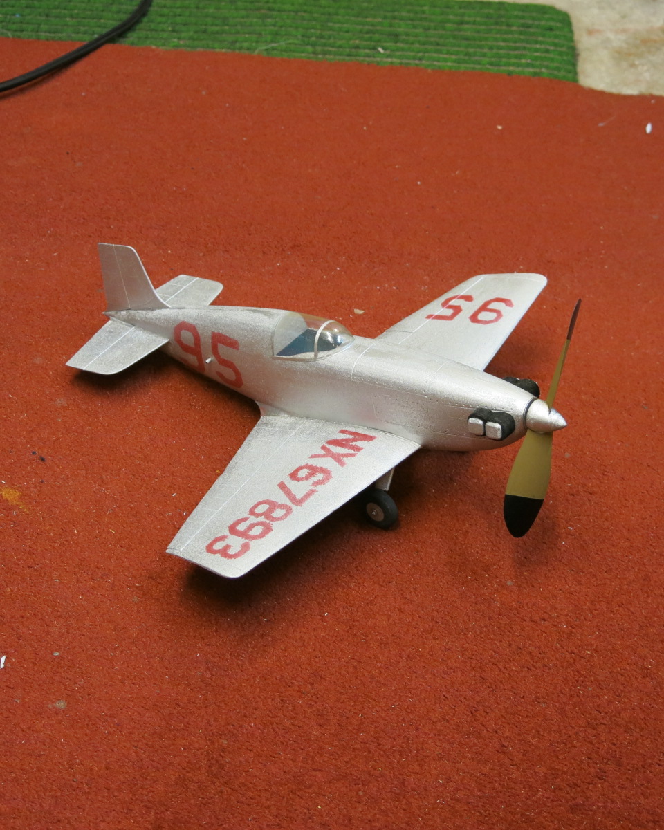

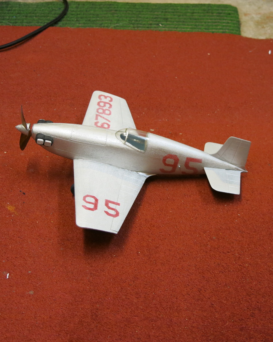

A brief report before I go to Clayton Green in the morning. The Californian is almost finished, just some detailing to do. I'm happy with some of it, unhappy with some of it and really annoyed about the rest!
The biggest mess up is with the Reg and racing No's which are red. I don't think decals will stick to the awful looking silver finish so I made masks and sprayed. Total disaster! Red acrylic paint doesn't work over silver acrylic paint, and masking tape doesn't stick very well to it either. The photos are very kind but to the eye even the darkest bits of red are pale pink at best.
Hopefully it will fly well or it might get accidentally trodden on :oops: .
