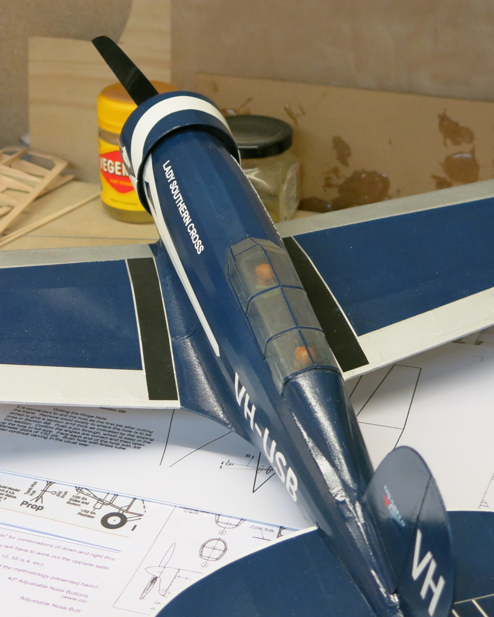

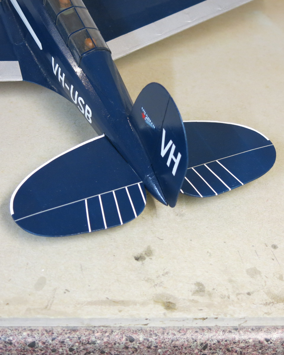

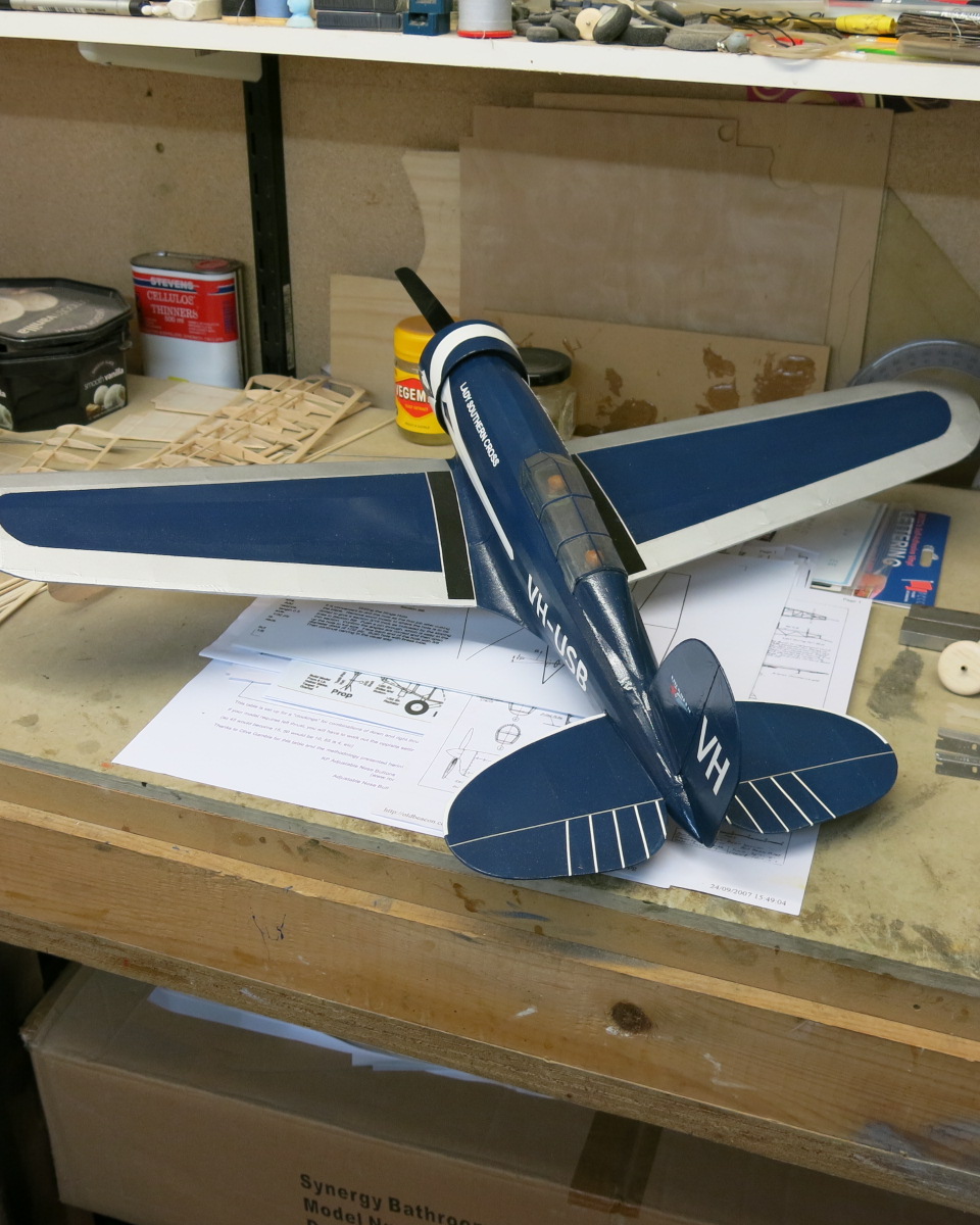

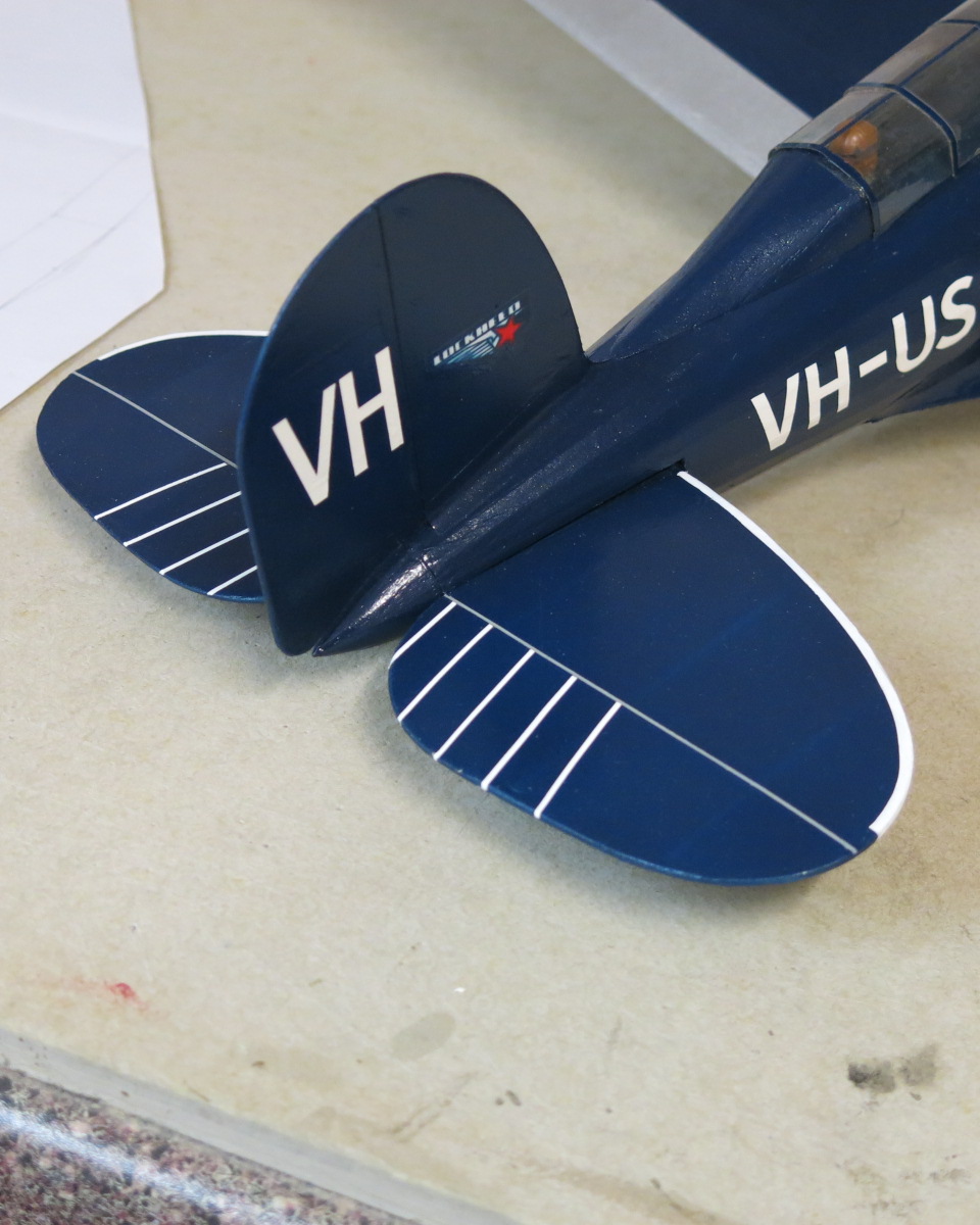

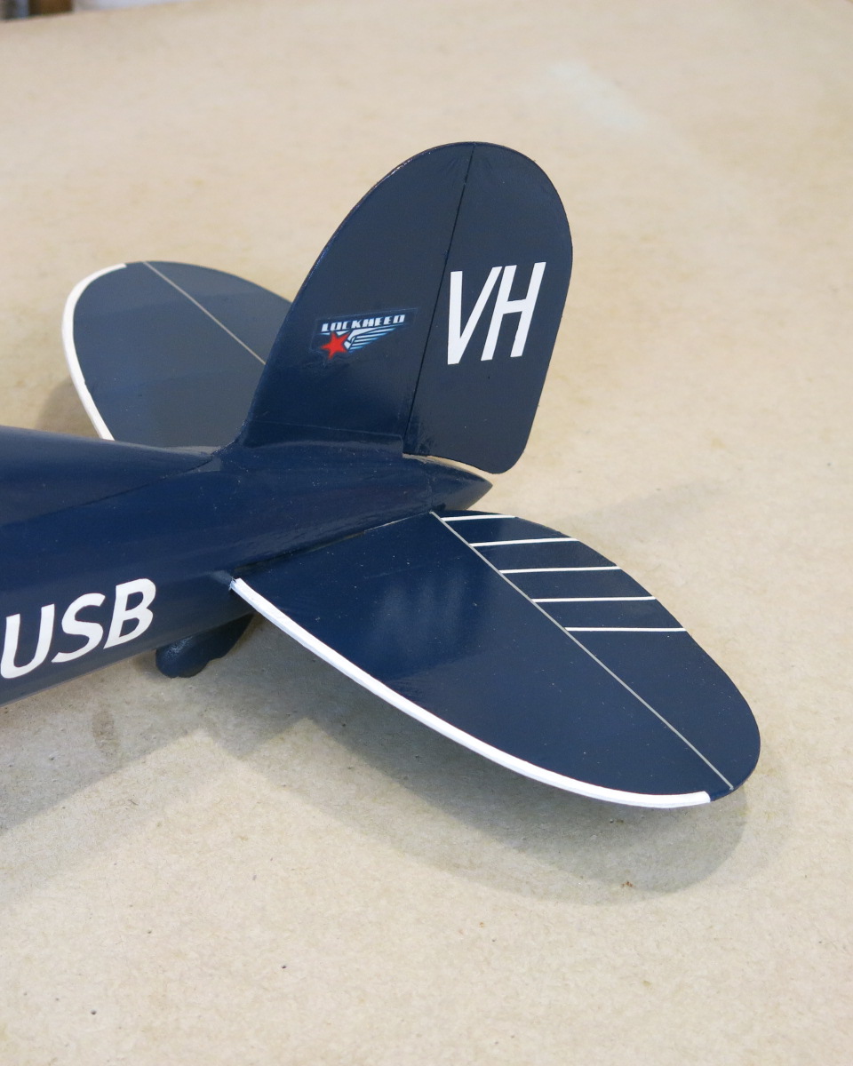

I have done a little more detail on the stab and elevators. The stab leading edge is white which I did by masking and hand painting. Then I needed an elevator separation line which I would usually just draw on with a pen, but on dark blue it needed to be lighter so that was masked and painted in light grey. Finally the decorative lines are cut from decal paper like the other white markings.

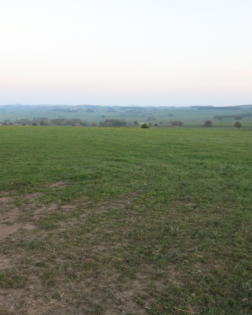

The promised Swiss weather arrived yesterday so I went out to the field just before sunset to try some trimming. I am quite pleased with the initial results although I have a lot more to do. I learnt a lot in a short time (this is my first electric model so it's a lot of new stuff all at once). Here is a pic of our field and a short video of one flight attempt which was fairly typical.

Hi Tim,
In static it looks pretty impessive. In flying it seems to be off to a good start. Rather brave of you to toss it outside, on the plus side there are no walls or tables, a little more grass would be more reassuring. It is a pity you only ordered swiss weather from Roman. He could have chiped in some tall grass too...
Seriously though, it looks very promising. Try to force it a little more to the right (wing weight, slightly more thrust, aileron tabs ?) until it you see it going straight. Then start running after it...

Hi George, It wasn't that brave to give it a go in our field, the grass in the middle is long enough to cushion landings. The pic is taken from the gate and is NOT where you want to land. If I turned left there and took a pic you would see a huge manure pile which is also not a good place to land .
What is your opinion on trying to go right instead of left? I was edging the rudder back bit by bit and at one point went too far and it did a right hand circuit and looked as good if not slightly better than going left. would you keep the right thrust setting (about 5deg as recommended by Rich Crossley) or change that if going right? I really need another evening at the field to try some of these things but sadly rain and wind has returned so no flying here for the moment.
