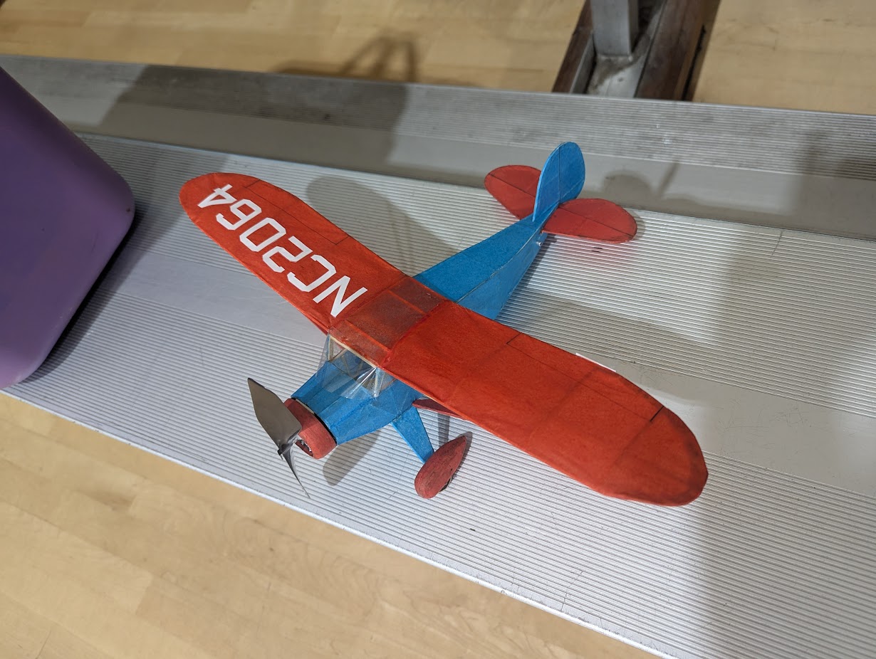

Well, here is what it looks like done. I took it to the OFFC Dimer contest this morning without being able to trim it at last week's session. The gym was closed last week due to a gas leak. Trimming a new model at a contest either goes surprisingly well or is a complete disaster. This time it was the latter, I finished last. Built with the wood and tissue in the kit it is a bit of a brick. With an 18" loop of 3/32" FIA Tan it weighs 21 grams. Not to heavy for a 16" span sport model but not competitive either. Bill Watson was the winner and was getting 1:40 times under a 22 foot ceiling with a parasol model, sorry, I don't remember the name of the aircraft.
I was correct that it would have been much lighter if I had scanned the plans and laser cut it using my own wood. The other thing is that I was going to modify the landing gear with a wire through the fuselage from one side to the other but I built it to plan. This worked landing on the slick, wood, gym floor but flown outdoors a landing in short grass would probably bring it to a stop fast enough to shatter the bottom of the fuselage. I have another Hi-Flier dimer kit, a Stinson 105 and I'll build that my way.
