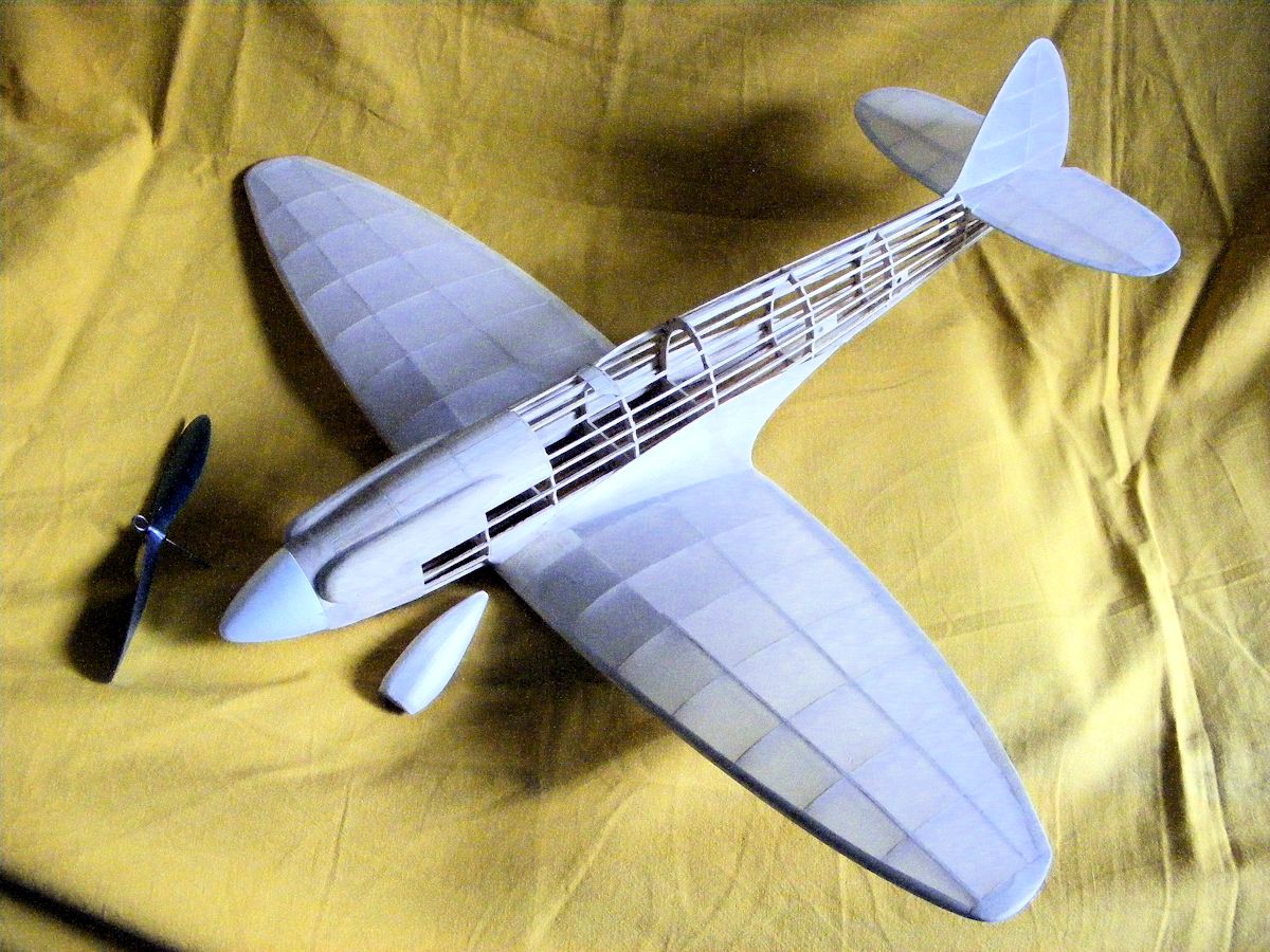

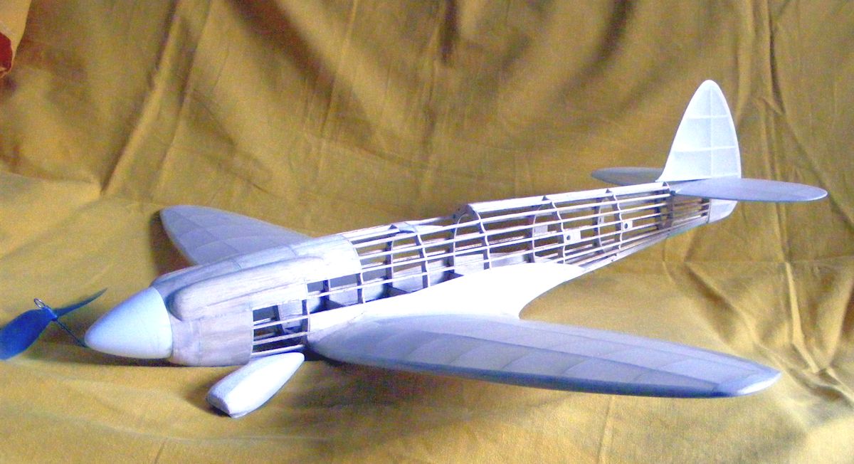

In a bold attempt to recover from a bad case of building lethargy, I dug this pile of bones out of the workshop yesterday afternoon and blew off the accumulated dust. The last work done was in Dec. 2012 :oops: ...
Filled in some areas that were not fully sealed, got the front part of the wing fairings done (sort of), sanded, two coats of clear to the rest of the airframe and then covered/shrunk the wings. Came out OK, but highlighted all the areas that didn't get sanded well enough - simply got impatient. Just the fuselage left to cover. Did a mock-up to get an idea where the CG is and how much weight I'd need in the nose - using the supplied prop/spinner - and will require approx. 4-5 grams. The infill I added was a good decision.
Getting the wings covered on the assembled airframe went surprisingly well.

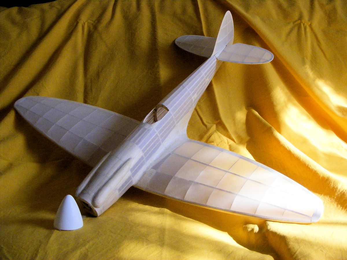

I got the fuselage bottom covered last night and, in spite of the compound curves plus working around the wing fillets and LE, came out very nicely.

I FINALLY got around to getting the covering finished on this buggar, using 5 pieces of tissue and three different glues. I have an off-brand glue pen (white glue) that I wanted to try and had only one sticky issue - dries well but the least bit of moisture/heat makes it "sticky" again. The glue doesn't let go (actually grabs VERY well) it is just "sticky". Probably will be all right once doped. This gizmo is great for getting the glue onto stringers.
The other glues were normal, thinned PONAL Express (white glue) and UHU Blue glue-stick.
This has turned out to be one of my best tissue jobs with jus a few minor spots to be tacked down (the areas at the front of the motor blisters). Weight of the covered airframe as pictured is 36 grams.
