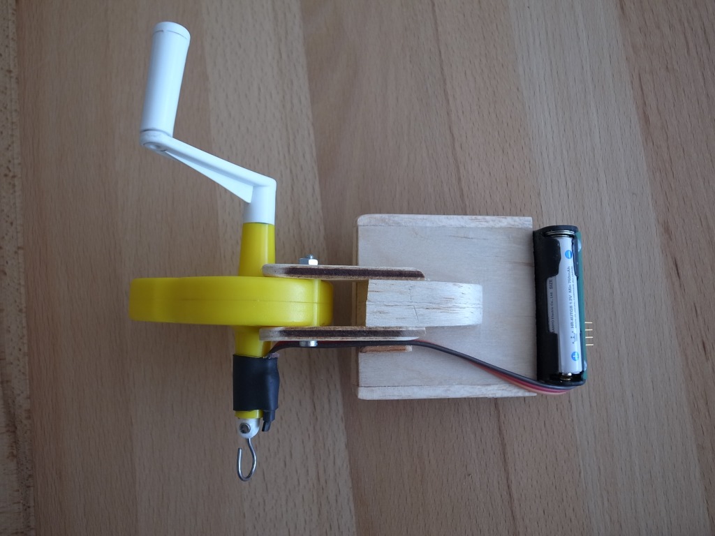

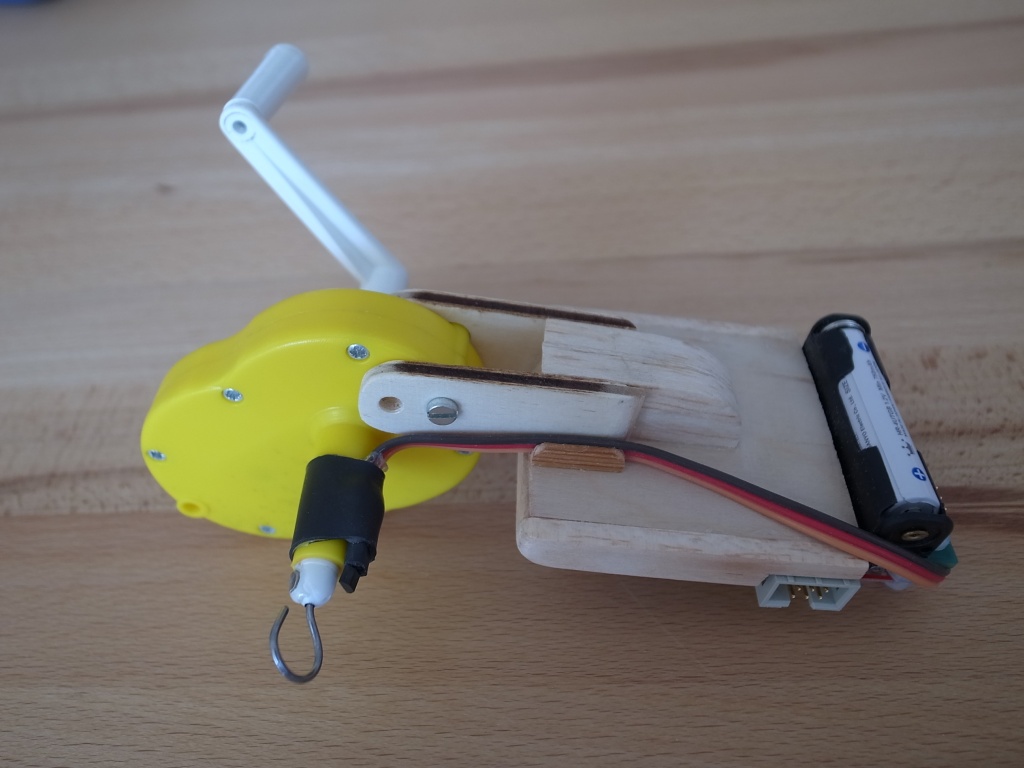

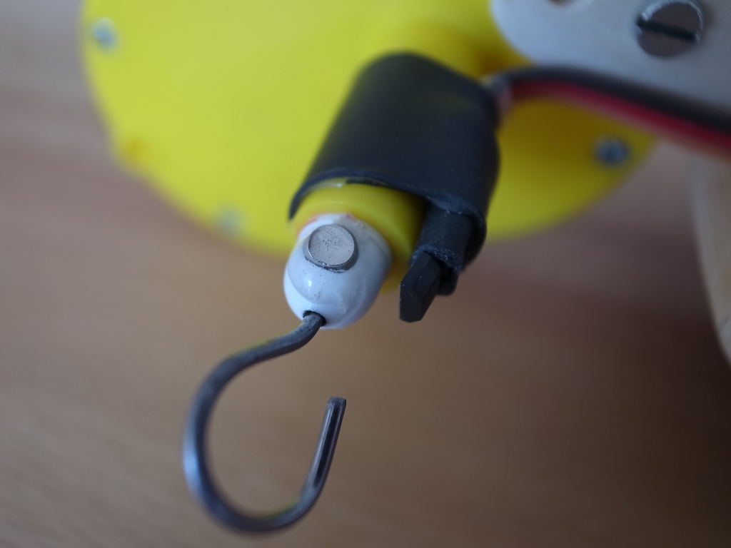

The counter should be universal. Which means, it can be attached to any winder you like as long as you can attach a small neodym magnet to the axel of your winder. A hall-sensor will detect the neodym magnet everytime it comes by and will increase the counter.

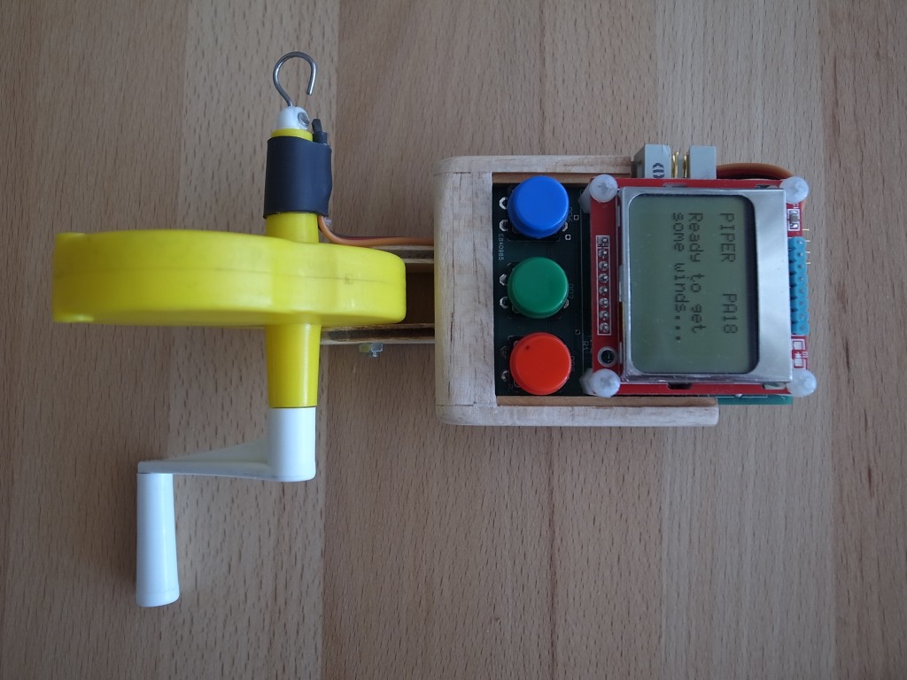

On the prototype,the holder is a bit rudimentary, but it works quite nicely.

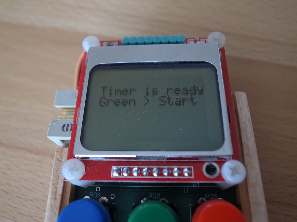

The counter is now ready for its function as a stop watch. If you press the green button again, the stopwatch will start and the time is shown on the display. If the model lands, you can stop the watch witch the green button and you will see the result. On the display you see what flight time you got with the winds cranked in.

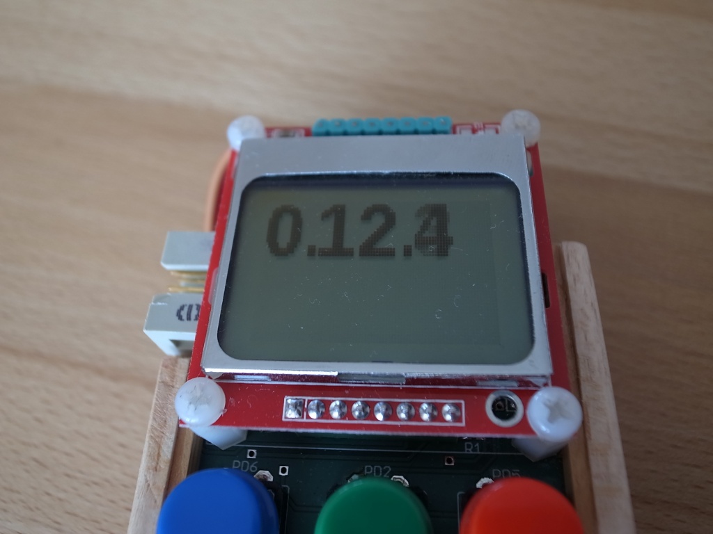

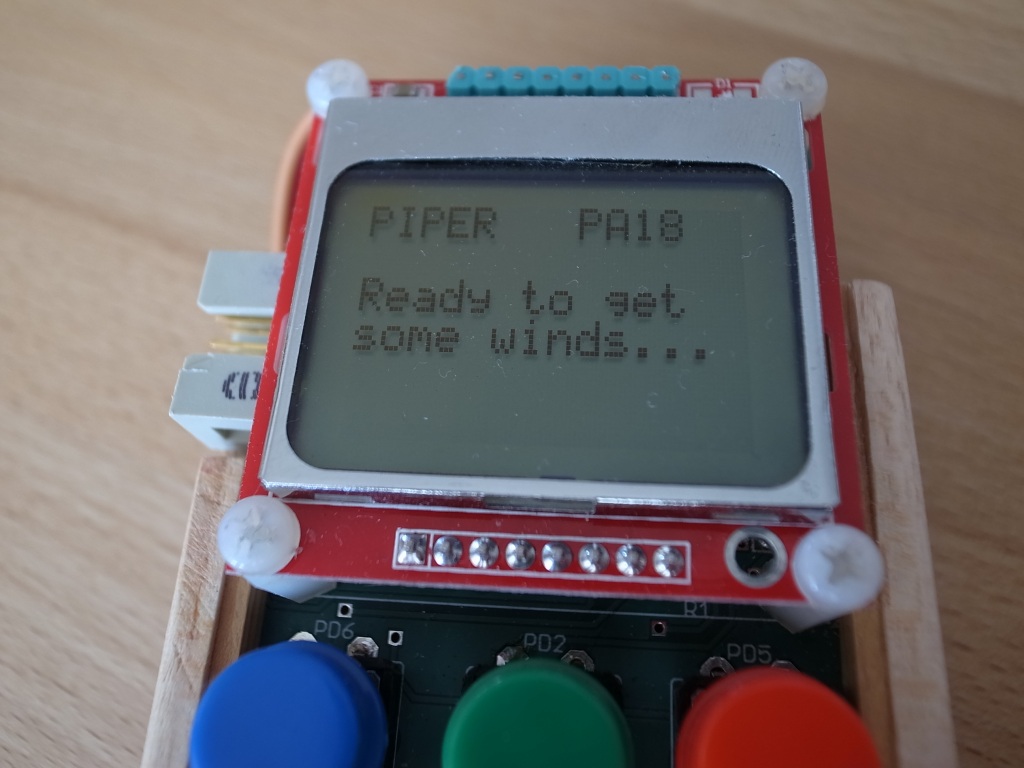

1. Start screen

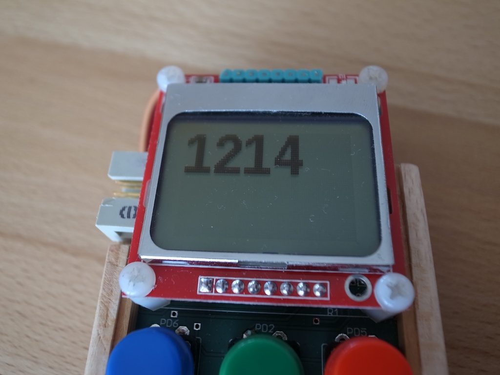

2. winds cranked in
3. close up picture of the neodym magnet and the hall-sensor.

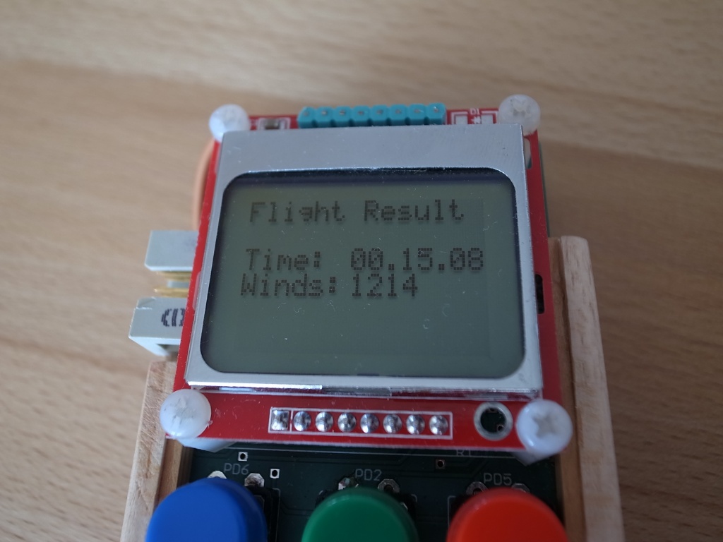

1. winder is ready to time the flight
2. stop watch is running
3. flight results are shown
PS: I know, 15 secs are not a great flight time for 1200 winds :roll: It's only a demo to show how it works... 8-)
